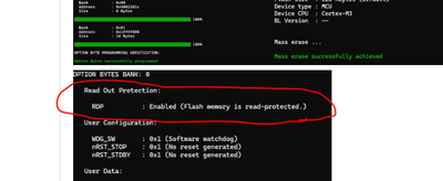

similarly when i try to flash through cubeprogrammer, its not getting connected. im getting error message:
UR connection mode is defined with the HWrst reset mode
I tried using STM32_Programmer_CLI.
there I found out RDP is enabled.
I did mass erase and write RDP =0xAA.
both commands were successful but still when I give the command to display, it's still showing rdp enabled.
I have attached screenshots of cli messages
how to solve this?

2025-05-11 11:54 PM
Did you notice this ?
Try to get your board into system mode (ROM bootloader), and perform a mass erase.
And remove/disable any code enabling this Flash protection for the time being.

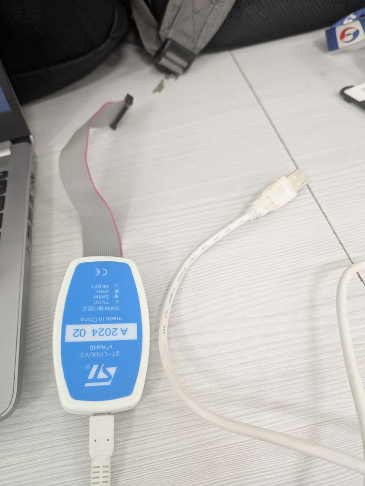

2025-05-12 12:17 AM
Please show a photo of your ST-LINK/V2.
Regards
/Peter
2025-05-12 2:27 AM
2025-05-12 2:35 AM

2025-05-12 2:35 AM
Your ST-LINK7v2 is a clone with a fake STM32F103C8T6. ST resources are only dedicated to supporting genuine ST products. We are not committed to ensuring that clones/fakes products work properly with the firmware we provide.
This thread will now be locked. However, if you face difficulties while using genuine ST products, we’re here to assist you. Please feel free to start a new thread, and our team, along with community members, will be ready to help you with any issues/questions you encounter.
Regards
/Peter
