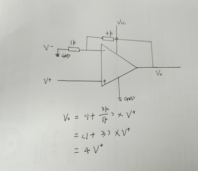

A picture is worth a thousand words: just add a schematic so that people can see what you are doing. It might then be possible to give you an answer, which is not possible now due to a lack of information on components in the vicinity of the MC33078.

Hello!
The schematic diagram is as below, on my side, I would like to know most of all, when the power supply of this model op-amp is a single power supply, what is the minimum input voltage of inverted end grounded and same phase end to work properly, thanks!

First of all, a note: the MC33078 came onto the market around 2000, when dual supply opamps were still predominantly used. Of course you can use any dual supply opamp with a single supply, but you have to pay attention to a few parameters.
One such parameter is the common mode voltage range, which is specified for a supply voltage of ±15V on the MC33078 (even if it is not explicitly stated in the data sheet) and has a range of (min) ±13V … (typ) ±14V. This results in a typical distance of 1V, maximum 2V to the rails, i.e. V+ and V-. You can therefore only feed the MC33078 with this input voltage of typically +1V, maximum +2V.
Does it answer your questions?

2025-03-07 6:10 AM
According to my last statement, you can apply an input voltage of +2V in the schematics shown in your picture, which would be amplified to +8V with a factor of 4, which requires a VCC of at least 9.5V (RL=10kohms) or 10.8V (RL=600ohms). It may also work with an input voltage of +1V, but this is only a typical value and cannot be taken as a guaranteed value.
The function of such simple opamps is not guaranteed outside the specification, so that no statement can be made for an input voltage below 1V.
