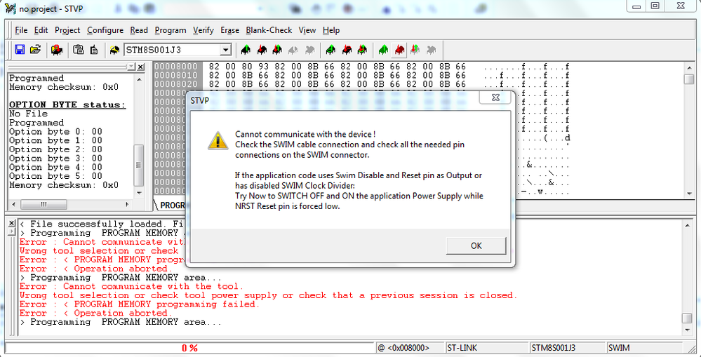

Hello, I'm having some problems with UART1 in STM8S001J3. I'm using the simple code below (the compilation is ok), but when I try to programming the MCU in STVP, a error happen and the MCU doesn't work anymore, even though I try to programming with a funciotonal firmware (like only GPIO port set). Anyone have any idea how to fix this? Or if there is another way to use UART1 in this MCU.
If I put this contidion in DISABLE, the programming process works normally, but UART doesn't work.

When this error happen, MCU doesn't work anymore:
Odd that when you reconfigure the pin that SWIM is using, it doesn't work subsequently.. Perhaps have some delay between reset, and reassigning it, so the debugger has a window to connect.

Hi, sorry for that. I was trying to change the TX port to see if this was the problem and I forgot to change back. But the error still happen with correct ports.
This is the 8-pin STM8 device right? What else uses PIN 8 ?
2022-05-11 12:35 PM
Yes, STM8S001 is a 8-PIN MCU. PIN 8 is a default SWIM of this MCU e and I only use as TX pin. I tried to use PA3 as TX but also doesn't work.
CLK_PeripheralClockConfig(CLK_PERIPHERAL_UART1, ENABLE);
2022-05-11 12:46 PM
PA3 would require a remapped configuration, (AFR0=1 and AFR1=1)
Pin 8 is bonded to 4 nodes on the internal IC, if you put one in Push-Pull mode it's going to preclude others being used as bidirectional, and you'll be fighting over who can sink the most current.
2022-05-12 7:03 AM
A simple delay in the start of main void solved the problem. The flash of MCU and UART are working now.
