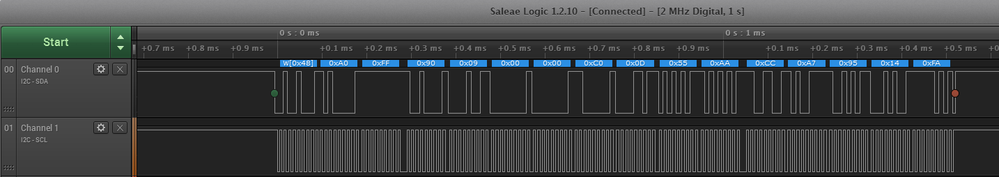

:Using an external device (verified to be working), I generate an I2C signal (100KHz) to communicate withSTM8S005C6
program as aslave
receiver with the7-bit address of 0x24
.I2C interrupt service routine is triggered by an incoming I2C signal. Address match and data receive events are detected. However, stop event (I2C_EVENT_SLAVE_STOP_DETECTED) is not detected. Through a digital logic analyzer, I see that each byte received has been acknowledged. And, stop condition is present.
