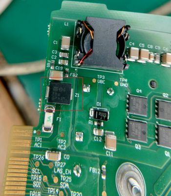

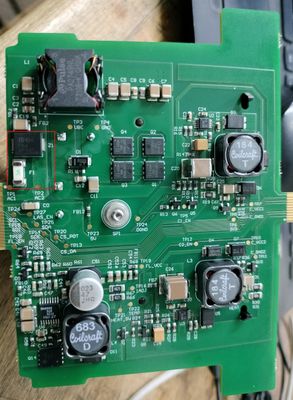

Dear Sir
Good day
Please be informed that the attached JPG file is power card for CCTV camera, the supply , The camera is connected to an operating voltage 24-28 ACV.
i need to know the part No. of Z1.
Please check and wait your advice
Best Regards
Mostafa
2023-09-10 7:18 AM
FBW SMCJ48CA-TR

thank you for reply
2023-09-10 6:12 AM - edited 2023-09-10 6:20 AM
Don't you have any indication on the name of this board, any reference. If you don't, can you give as a product using this card.
Best regards.
II
2023-09-10 6:35 AM
written on this item the next
FBW
GP439
and logo for ST microelectronics company
best Regards
Mostafa
2023-09-10 6:58 AM
Can you give the name of the board in the picture or at least the name of the system using that board. That can help as finding the reference of the components you are looking for.
Best regards.
II
2023-09-10 7:18 AM
FBW SMCJ48CA-TR
2023-09-11 2:23 AM
dear Mr.Tesla .. good day. i confused from your reply.I sent an enlarged picture of the Z1 so you can read the written data. wait your advice. best Regards
Mostafa
2023-09-11 3:12 AM
I don't understand your problem? I gave you a specific part number, and you provided a larger more poorly focused picture of a part we've already seen and decoded the marking from..
