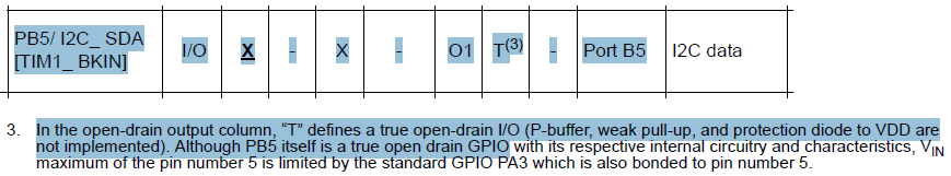

PB5 is true open drain pin. This means that this pin can only set logical low state, not high. High state can be achieved for example by adding external pull-up resistor. Description of PB5 you can find in STM8S001 datasheet:

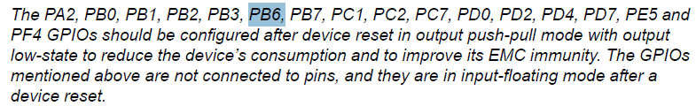

PB6 is not available in this device or to be more accurate it is available as a pad inside the package, but it is not connected to any pin on the package. Description is again available in datasheet:

Instead of an external pull-up for PB5, one could use the internal pull-up of PA3 (see section 7.3 of AN5047).
Philipp
2017-10-31 3:52 AM
Very nice idea. Thanks for it Philipp.
Regards
Szymon
