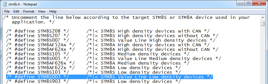

I have checked it and you are right that Standard Peripheral Library for STM8S doesn't include new STM8S001J3 device. It seems that libraries were not updated by us. I am sorry for this inconvenience and thank you for reporting it to us. I will provide this feedback to the team, which is responsible for these libraries.
As a temporary workaround I would recommend you to select the
STM8S003 as used device in Standard Peripheral Library. I used this approach and I didn't have any problems to control ADC, GPIOs, UART and timers ofSTM8S001J3 by fuctions from Standard Peripheral Library
