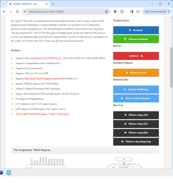

2024-02-28 4:16 AM
To learn how to use the Wiznet W5500, go to the Wiznet Product Page for the W5500:
Note the links to Technical Documentation, Drivers, and Support.

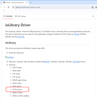

Following the 'ioLibrary' link:

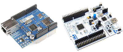

Here's an example using a Nucleo-F103RB board and an Arduino WS5100 shield:
https://www.carminenoviello.com/2015/08/28/adding-ethernet-connectivity-stm32-nucleo/
It's using plain Eclipse rather than the STM32CubeIDE - but that should be close enough to get you going...
It uses the Wiznet ioLibrary - mentioned earlier - which also supports your WS5500...
