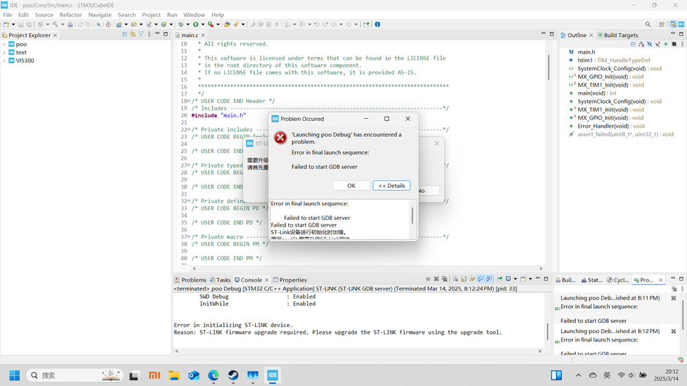

STM32IDE (1.18.0) for the STM32F103C8T6 always fails to start the GDB after download and installation, and there is no method on the web page or official manual. Recent successes are STM32IDE (1.17.0) still working in mid to early February, and STM32IDE (1.17.0) not working at the end of February. (ST-link V2 to STM32F103C8T6)

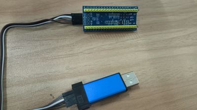

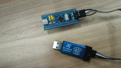

please upload a legible photo (front and back) of the ST-LINK/V2.
The board with STM32F103C8T6 - is it a so called Blue Pill?

2025-03-14 6:25 AM
See message in console : wants st-link update first !
So go menu Help -> st-link upgrade ...
then try again connect/debug .
2025-03-14 6:37 AM
It says you need to upgrade the STLink firmware. I would suggest starting there.

2025-03-17 5:06 AM
So, yes - that is a "Blue Pill".
Beware that it's likely to have a fake STM32:
And that's also not a genuine ST-Link:
2025-03-17 5:54 AM
1. did you upgrade ?
So go in IDE : menu Help -> st-link upgrade ...
success ?
2. connect setting in IDE: software reset
-> then try again connect/debug .
-> then it should work.
