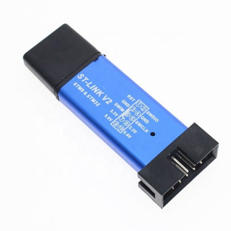

It also seems there are different versions of the st-link v2, but with the same name:
I prefer the small thumb-drive like, if they are functionally equivalent.

The thumb-drive one is a boot-leg design.
Should however present 3.3V and 5.0V at the connector, could power with that.

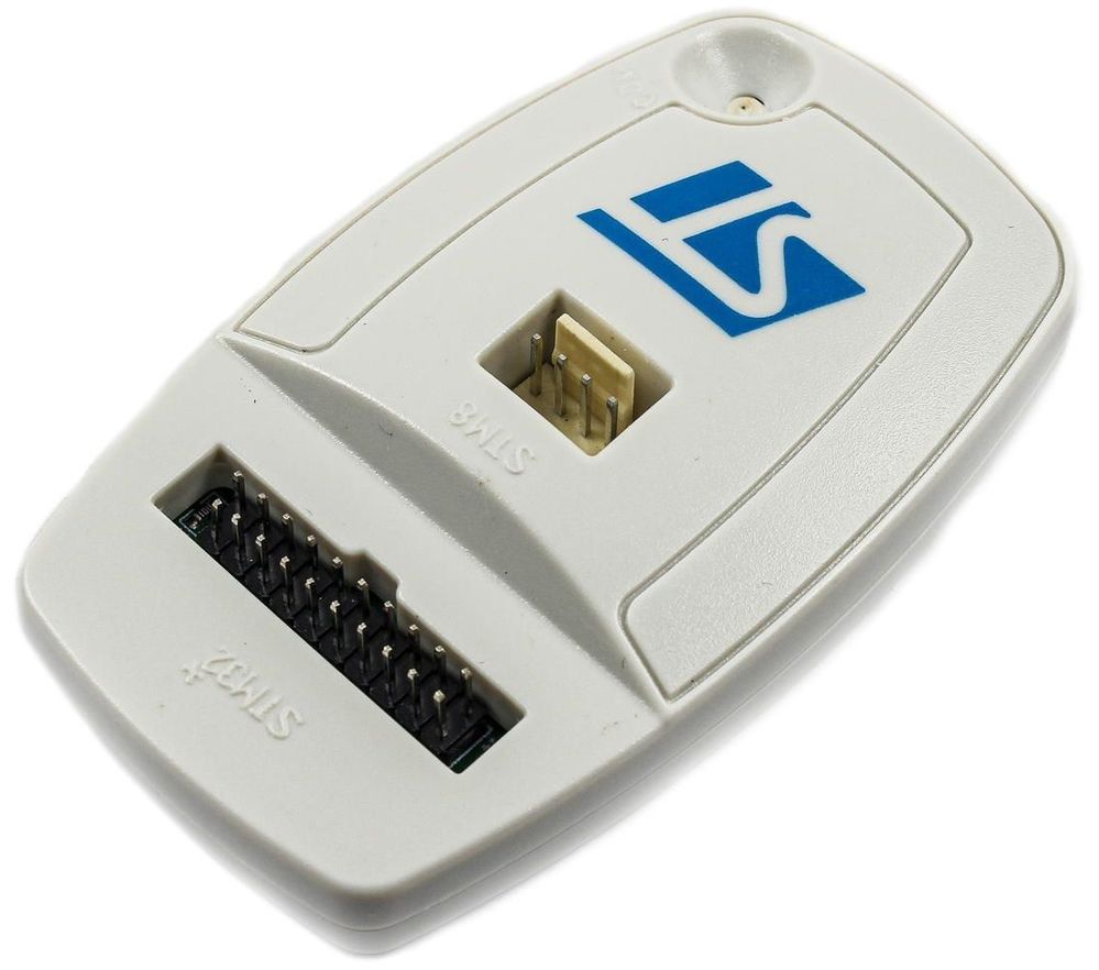

The Authentic ST-LINK/V2 provides power via pin 19 of the 20-pin JTAG header, whereas pin 1 and 2 expect the Target's voltages for the buffers on the pins.

I'm not using the STM8 / SWIM
Like I said both those pods will have power available, so use a flying wire as necessary, and use a multi-meter to check the pin levels. Will take you a few seconds to confirm.

Yes we use the tag-connect cables on our boards. We use the ST-Link-V2, (the white one in your picture) the tag-connect adapter, and the tag connect cable (10 pin version)
