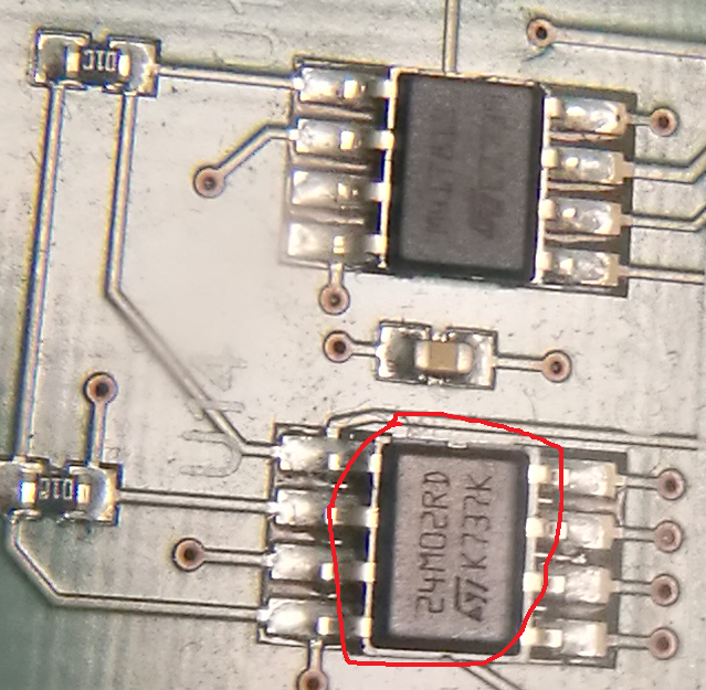

I'm facing a problem to get the eeprom working since whenever i try to write a page (256 bytes) or partial page with HAL_Mem routines the read function seems to read at the beginning wrong informations.
First of all i wish to clarify what eeprom code i've got on my board. In the figure below i'm seeing 24M02RD but the right name should be 24m02DR. Why? is the code correct? What does k737k mean?

737 might be the datecode for 2017 week 37... the rest no clue.
