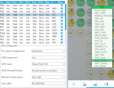

By discussing with ST, the issue has been solved. For anyone that wants to recreate the DCMIPP Continuous Mode, here are some things to keep in mind:
The NRST and ENABLE pins that connect the STM32N6570-DK to the MB1854B board are not configured by default, so you need to configure the pins as GPIO Outputs and to the context of your project. Keep in mind that NRST is active low as well.
When using the DCMIPP with CSI, you won't actually see it in the clock tree, but the CSI requires a correct clock configuration as well, which is connected to IC18, you should configure it's frequency to, at maximum 20MHz, if I'm not mistaken.
You can assure your IC18 configuration is correct by looking at the hal_msp.c file after CubeMX code generation.

- If you are using CubeMX, check if your NRST and ENABLE pins of the camera are in the right context (FSBL or Application)
