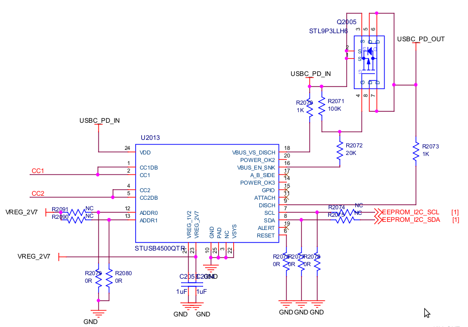

This is the PD schematics, and I try to set the PDO1 5V 1.5A, PDO2 9V 1.5A, PDO3 12V 1.5A, and send soft reset
Are these the correct configuration steps?

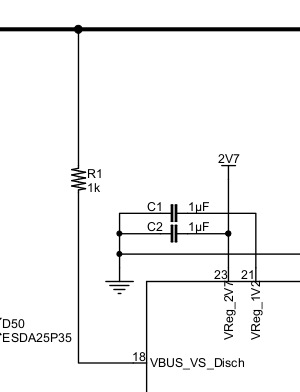

Looking at your schematics, I see that you did not implement the discharge circuit as in our schematics (see below).
This circuit is recommended, especially if you are expecting high current surge, because:
Please add this circuit and let me know.

use the STREF-SCS001V1 schematic above, Is this difference the cause of the problem?

If you have some spurious on VBUS, it could be detected as "VBUS under-voltage" by the STUSB4500 : these schematics filter these unexpected drops.
