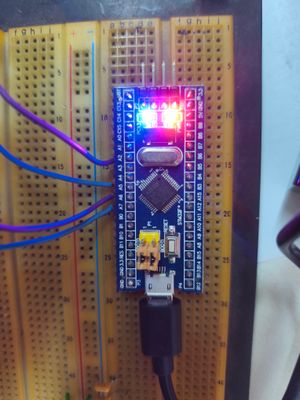

2026-02-09 9:36 AM
Dear Andrew,
you're right. If I remember well the board name is Blue Pill.
For be sure I attached the picture of them.
Thanks
