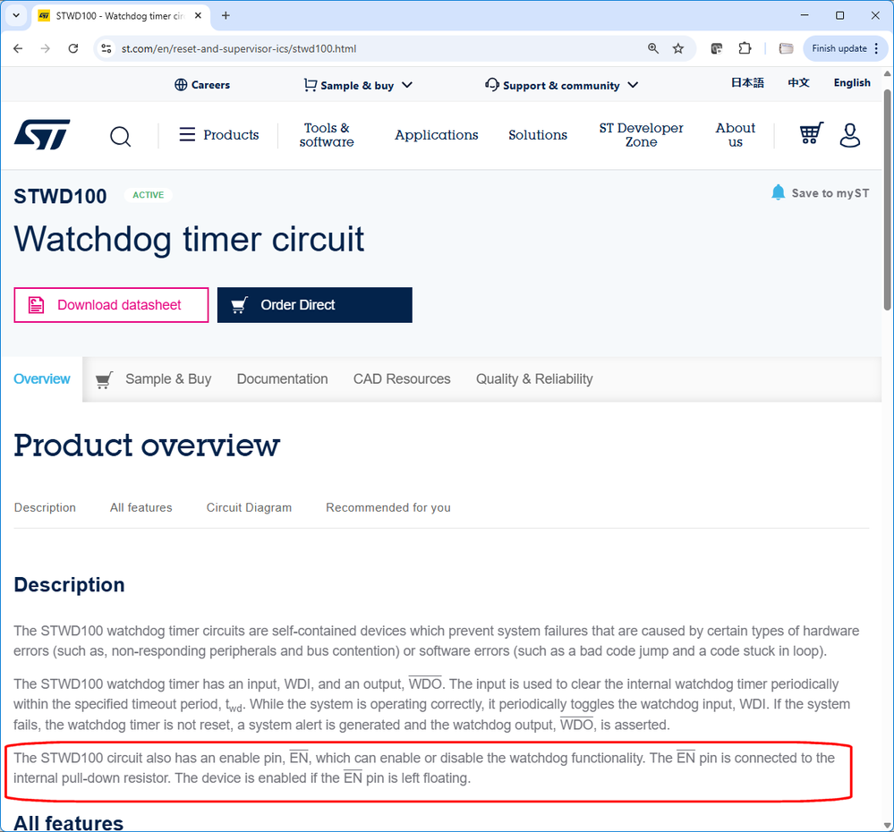

This is a common issue with any external WD - nothing to do with the STM32, and not specific to the STWD100.
The STWD100 has an Enable pin:
2025-06-10 6:27 AM

It might have been a better approach to have connected the -EN pin to a programming header or MCU pin
