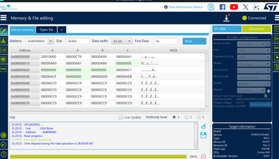

Here are some screen shots.
Any suggestions as to what to do to get CubeProgrmmer to see the ST-Link v2.0 hardware on Windows 11.

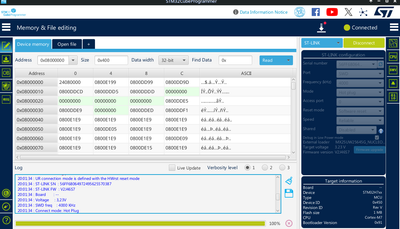

See, this is connection to H743 with a "clone" , st-link V2 stick :
HW-reset telling ...nonsense, its on software reset. working. As the sticks have no working hard reset...
but i work with them since years; just now more with the new st-link V3 , mods or miniE , but the old V2 sticks also working.

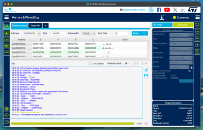

This is what happens on MacOS with the same hardware. Firmware is apparently the latest although not the same as yours. Just programmed the factory code back to my blank F401 no issue on the Mac but Windows is having none of it. :) By hardware I mean ST-LINK and Black Pill No computer .
re firmware - I am returning these ST-Links but if the seller does not want them back I'll try a upgrade if I can find the files (cube Programmer says firmware "unknown" when I click "Firmware Upgrade". even though they both said they had already upgraded them before shipping. Defo will check with the known genuine from Mouser though (if it too has issues)

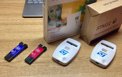

The picture below shows the programmers I have.
from left to right:
Blue and Red mini sized things, as pointed out to me in another post, are just copies but at least they are obvious about it and was recommended to me by the project developer and at the time of buying I was not aware of the "white" type. First (left most) White STLink V2 is in my opinion a counterfeit with many subtle differences. (led, pin header opening, colour, rear label, weight, text colour and moulding)
All of those mentioned thus far work fine on a Mac but not on ether of my Windows Laptops or my neighbours machine. (No ST Link found or hangs on connection to a target (NuCleo))
The White one on the far right is Genuine from Mouser and works on Mac, Linux and Windows faultlessly.
So if you are looking to buy a programmer/debugger make sure to get it from a recognised distributor. it's not worth the £2-3.00 saving. (I have even spotted the words "Compatible with STLINKv2" on a couple of online shops, so be careful)
