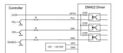

Sooo...
Its about DM422c - right ?
You need anyway just 3 lines : pul, dir, ena. +opto for power.
Set pins as output, open drain . PA8 , 9, 10 . + on opto 5V vom USB port .
(not PA0...123 , they are NOT FT - 5v tolerant !!! ) RTFM !!!!

I would like to go on OPTO with an open common PIN as input voltage... but your solution seems to be more comfortable.

Ok - in common I think, that my control voltage is too low. The motor sounds in this way.
In look to the USB voltage, there is no possibility to get this voltage per software?
2024-02-15 12:56 PM
What actually does VB means?
Is it possible to give there a voltage input ~5V on the card?
