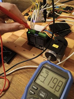

2024-02-15 9:43 AM - edited 2024-02-15 9:45 AM
2024-02-15 9:52 AM
Numerous posts have all asked you to measure this with nothing connected.
I asked you, "Please confirm that is with nothing external connected to the Black Pill?" - and you show this:
So you do have external stuff connected!! :face_with_rolling_eyes: :face_with_rolling_eyes: :face_with_rolling_eyes:
I'm out.
