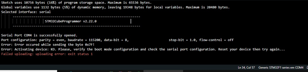

I have this Mini STM32F103C8T6 CH340 board which supposedly has the original chip (photo), I configure it as suggested in a post I saw here but it gives an error (attachment).
Does anyone have a solution?

Rather than a screenshot, it would be more useful to copy & paste the text.
So you're trying to use the serial bootloader, and that is failing.

Thank you for your question. Based on the information provided, it can be due to a non-genuine ST product.
We recommend contacting your seller or the third party where you purchased the product for further clarification. For assurance of buying authentic ST products, please purchase exclusively through our official distributors listed here: ST Official Distributors
