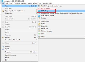

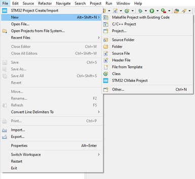

2026-02-26 12:41 PM - edited 2026-02-26 1:23 PM
@Retired wrote:
Yes, he can. It is my first project (after trying some ways to create a
new project)
No it cannot. probably you are talking abaout a previous version of CubeIDE. CubeIDE 2.0.0 and later versions cannot create project for STM32.
As you can see that option in CubeIDE 1.19.0:
Is no more available starting from CubeIDE 2.0.0:
