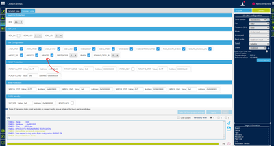

I solved that problem. nBOOT1 option of some boards is selected as a default. I connected to board via st-link and disabled this configuration from options bytes.
Thus I able to programmed with TouchGFX. I guess should continually active-deactive this configuration. I needed to disabled again this configuration.

Just clarifying for others - your tutorial recommends disabling nBOOT_SEL, not nBOOT1 as isikli suggested.
Disabling nBOOT_SEL worked for me (uses BOOT0 pin to run bootloader or app).
Disabling nBOOT1 lets the UART bootloader work, but then you have to re-enable it to run your app.
Worth noting that, contrary to your tutorial, the TSD module I received did NOT have nBOOT_SEL disabled - I had to connect an ST-link to it, to change the setting, before I could program via UART
