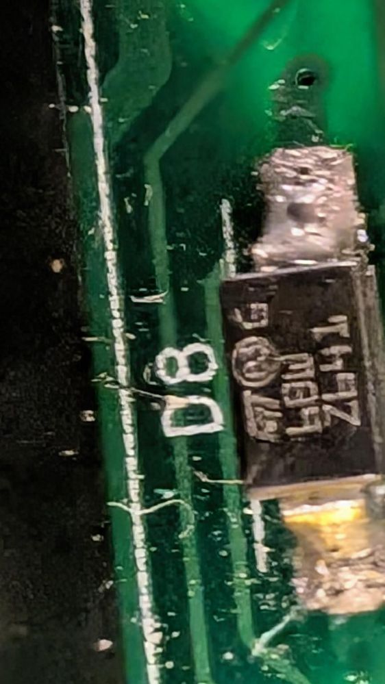

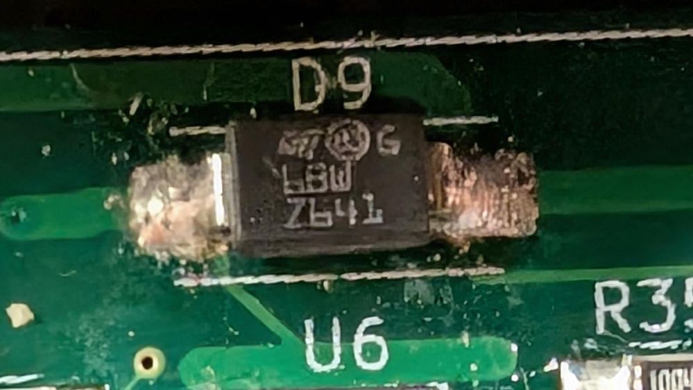

Can anyone identify this diode? I am looking to purchase a replacement but am unsure of the specifications.
2025-06-23 2:18 PM
SMA6F30A
Datasheet - SMA6FxxA - 600 W TVS
No longer manufactured, but should be easy to find something equivalent.
2025-06-23 2:18 PM
SMA6F30A
2025-06-23 7:30 PM
DigiKey has a Vishay SMA6F30A-M3/H
https://www.vishay.com/docs/89458/sma6f5.pdf
