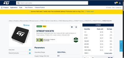

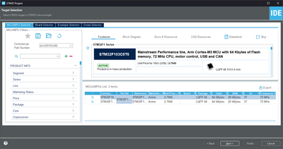

It would be really helpful if the fake STM32F103C8T6 didn't show up in the target selector in STM32CubeIDE
Also, it shows up on ST's website as a valid product: https://estore.st.com/en/stm32f103c8t6-cpn.html

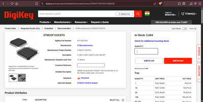

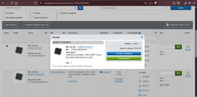

Also, shows up on digiKey, Mouser etc.
I am pretty sure ST sells it as a valid product, anyways I already looked for the nucleo f103 board you suggested from mouser and am buying it.
