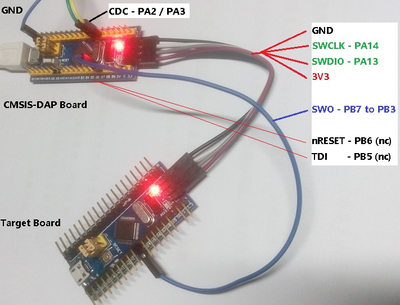

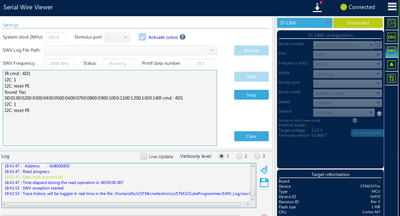

2025-09-10 10:42 AM - edited 2025-09-10 10:44 AM
>Do (any) STM32 support that ?
Yes. On the "clone" ST-link V2 just need to connect to PB7 , UART1 Rx , to get the SWO data.
(The pic i showed, with CubeProgrammer connected to a H743 cpu showing SWV data, is made with an modified
ST-link V2 , working 100% reliably at 2 Mbit. With a ST-link V3 higher speed is no problem.)
here with cmsis-DAP , also STM32F103 cpu :

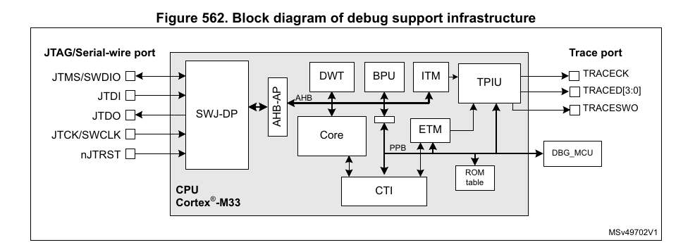

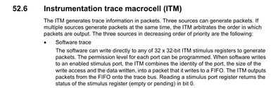

This protocol is supported if bit [11] of the Device ID Register, 0xFC8, is set. It is enabled when bits [1:0] of the Selected Pin Protocol Register, 0x00C, are set to 2'b10. Data is sent out in packets of ten bits, with start and stop bits, as shown in Figure 11.11 and Table 11.12. Capture devices are expected to operate at the same clocking speed as the TRACESWO pin and synchronize by waiting for a start bit.
