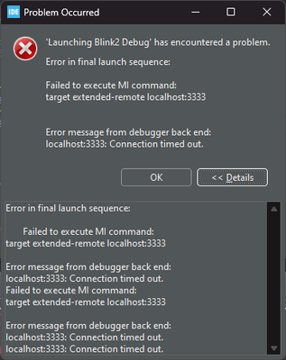

I have attached the 'error.png' file below it is a 'failed to start GDB server error' (for people who cannot for some reason see the file). I have done the following troubleshooting steps, which I found on chatgpt, youtube and this community:

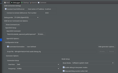

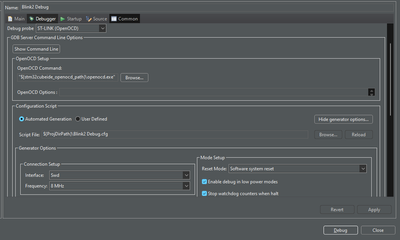

1) Check debugger configuration settings. (attached screenshots)
2) Tried lowering the debug frequency from 'Auto'.
3) Tried all reset behaviors: 'Connect under reset', 'Software reset' etc...

At this point I think I tried everything I could find online, I really hope someone from this community helps me find where I went wrong, or if I am making some silly mistake. Also, I tried using the STM32CubeProgrammer and the code flashes just fine (I still want to try the debugger).

In IDE you could try using other debug -> openOCD
And set : software reset (hardware reset not working on "V2 sticks" ! ).

Thank you very much for the reply! I tried it as you suggested and it didn't work:
I don't want to reply with this (I really want your help), but its okay you don't need to help me here as I am pretty sure that my stuff is fake (128kB flash and 20 kB SRAM) and even if we get it to work now, it will eventually end up with some other problem with the ADC or sensor interfacing protocols or something. I will use it with Arduino IDE for now and look for some other nucleo or discovery board.
