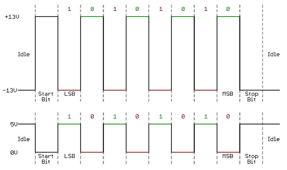

It's a polarity reversal, so if the transmitter sends in normal mode, and the receiver receives with reversed polarity, the bits are reversed. It should look similar to what the bitwise function does (var2 = ~(val1);).
Note: The TTL signal (0V to 5V or 3.3V) is already inverted in the RS232 protocol, so it's good not to confuse things.
