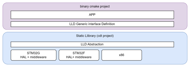

To generate a multiplatform code I defined a SW architecture and packaging as follow :
Build system :
At first sight the APP would be a complete application and the LLD a library providing only the HAL calls. That would mean that the APP hosts :
I am not sure the HAL could work with independently defined interrupt handler so I let those be part of LLD except the linker script (present but not used).
The LLD package contains :
Issue to create the HAL as library : it needs to be configured as a full binary. The workaround was to let it as is for project generation, and then in the project setting change the artefact to build as static library.

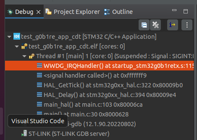

When launching, the sw hangs at startup, with an "unexpected interrupt".
I can bet it is the systick since the value is always 0 before the crash :
Also I called in the app code HAL_SuspendTick, and the crash does not happen anymore.

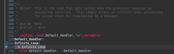

But in fact in the list file I don’t find it at this address but the default handler :
08000690 <ADC_COMP_IRQHandler>:
* @retval : None
.section .text.Default_Handler,"ax",%progbits
Default_Handler:
Infinite_Loop:
b Infinite_Loop
8000690: e7fe b.n 8000690 <ADC_COMP_IRQHandler>
So during linkink process the Systick_Handler is replaced by the default handler, but why ?
