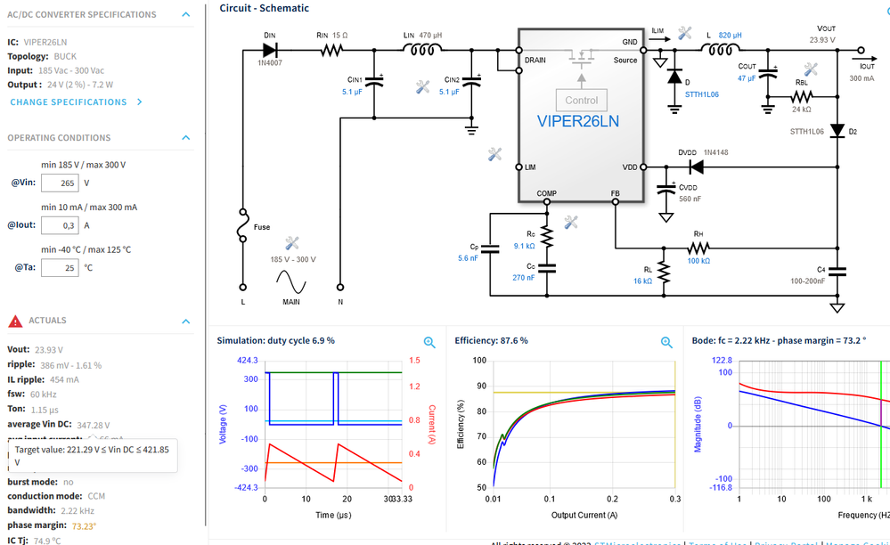

Okay because the option was selectable inside the eDesigner, which was probably some bug than (see picture below). By the way the VIPER are really powerful! :)
Nevertheless the VIPER267K is only available with the SO-16 package. Is there something available with the PDIP 7 package and equal pin-out than the VIPER26LN which can handle this conditions?

The VIPER26K is indeed not available in DIP.
But with the screenshot, the requirements are a little clearer and the VIPER26LN should work for your application - if the conditions fit.
If I understand you correctly, everything works down to approx. 180VDC, right?
What voltage range would you want to cover?

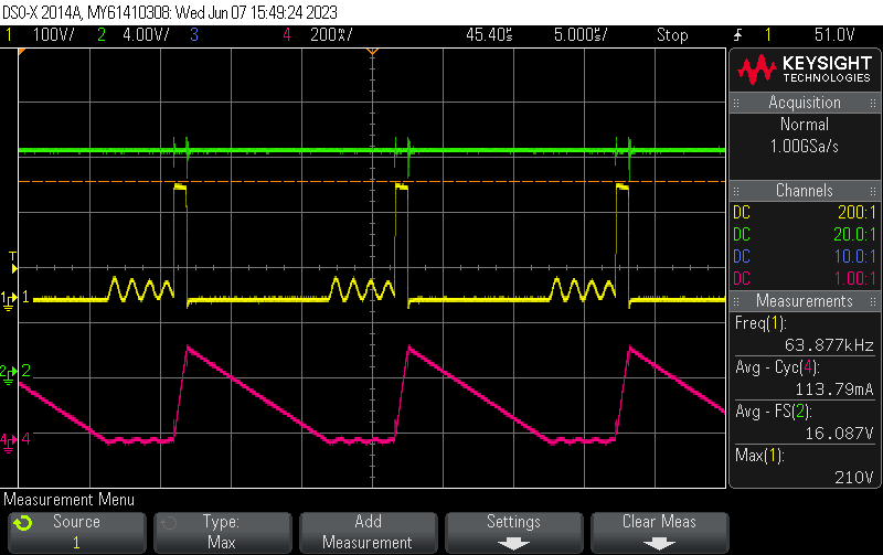

maybe to clear up things a little more. The first image (scope_1) is done with 204VDC, 214 Ohm of bleeder resistance + some other circuitry, 470 µH and 47µF cap. This results in a avg. current of 100mA. Switching f is 63 kHz and clearly in DCM. ton time around 850 ns. If I increase the voltage to 207 it will stop.

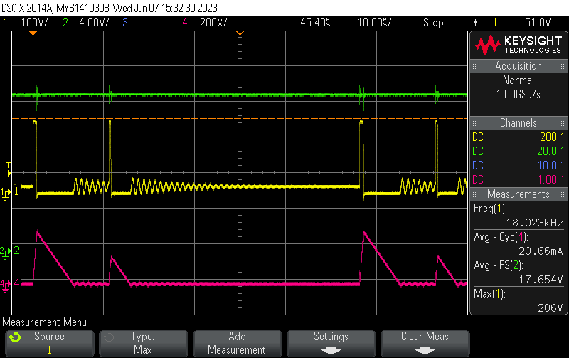

The second image (scope_0) was done also using 470µH and 47µF cap (50V) with a VDC of 206 volt. Here the burst mode is active as the avg. I is only 20mA.
After this (around 207VDC) the circuit tries to restart . I can't identify the reason for this as no overcurrent is given and no minimum ton time is reached...

In order to recognise a component as a fake, at least the Bulk ID is required, which can be found on the sticker of the packaging. If you have it, you should keep it confidential and only give it to us via PM and as a photo for verification, because otherwise it can be misused.
However, I do not suspect a fake component, but other reasons. You are not yet at the min on-time, but you are getting closer and closer to it as the input voltage increases, whereby the parameters of the surrounding devices become increasingly noticeable: especially the layout should be mentioned here, but also the parameters of the buck coil, for example.
If you have a contact, e.g. the FAE of a local distributor, you should take a look at your setup together with him to narrow down the problem.
