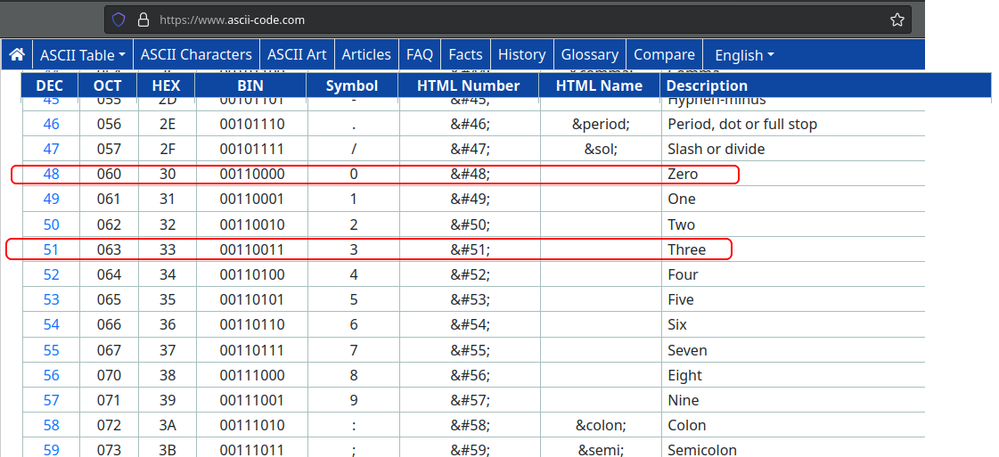

If it is "3" from the ASCII table then it is necessary to convert ASCII to decimal:
The value of the character "3" from the ASCII table is not 3 in decimal. The value of the character "3" in ASCII is 51 in decimal:
Table here: https://www.ascii-code.com/
Since characters start from "0" to "9", a programmer can convert the character "3" to ASCII by removing the value of the character "0" in ASCII.
This way the decimal value of the ASCII character "3" = equal to the value of "3" - "0" = (51) - (48) = 3 (which is 3 in decimal).
No inversion occurs anywhere in this conversion.
Note that the character "3" from the ASCII table is considered just a SYMBOL, not the relative position value (which would be 51 in decimal base, or 063 in octal base, or 33 in hexadecimal base).

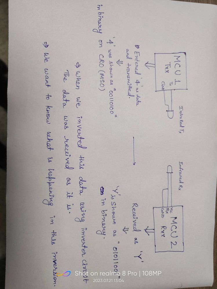

when we inverted this received data ('Y') using an inverter circuit( using Transistor) the actual data ('4') which we were sending from the mcu , was received in Original form  (4).
our Expectation is to know the logic behind this inversion , so that we can directly use this logic in our program on the receiver end , and Receive the Original data without using any inverter circuit.
Seems to be a problem with the communication, what is the schematic for that IR part?
How is the transmission and reception via IR being handled?
To simplify the IR transmission, a base frequency is used (carrier frequency), usually 38kHz, and spaces between the pulses, in this way a protocol is created that can identify the signals, such as NEC Remote Protocol and RC5 Remote Protocol.
