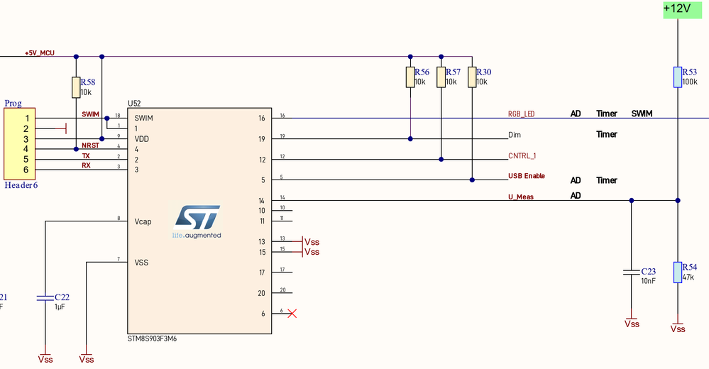

Using a resistor voltage divider (100k+47k) to break a range of 11V - 14V down to an ADC input range below 5V. For 11V i expect 3.5V, for 14V I expect it to be 4.5V.
(see schematic)
STM8s903 - ADC_IN_2 on PC4 (physical pin 14)
IAR embedded workbench 3.11.2 and STM8 SPL V2.3.0
The ADC works as expected on the selected pin. It converts values in the range of 400 - 600 and even a 0 code if I short circuit the bottom resistor to GND.
However, the voltage at the input pin and voltage divider is wrong. Meaning, the GPIO is probably not floating but driving this point. I have assembled to identical boards and both behave the same, tge first board has 2.5V the second has 2.9V.
This voltage stays at this value even if I change the top voltage from 11 to 14V.
Where it gets really strange is that this is not even always the case. For like 10% of the times, I actually observed voltages 3.5V up to 4.5V at the ADC input pin. Unfortunately, I have not been able to isolate the condition where this happens. It is independent of the STlink (swim) being connected or not.
Also on the schematic, ignore pins 13 / 15, they are disconnected from GND.
Why is this happening? It just looks like such an easy thing but fails to work. What setting am I using wrong.
