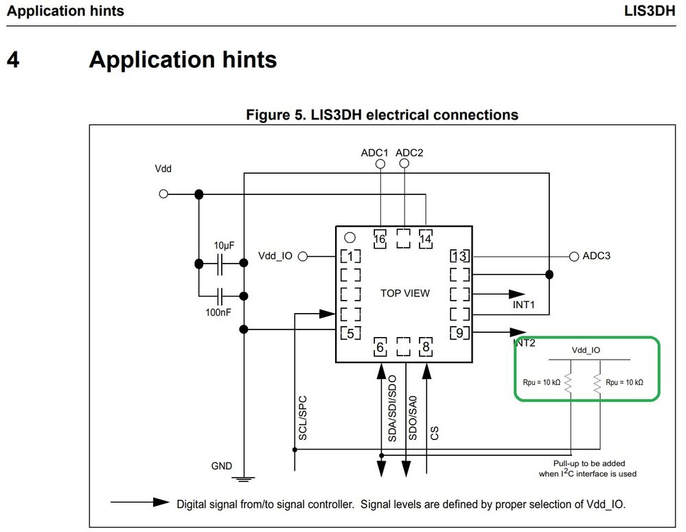

Considered standard bus capacitance for the resistor calculation is 400 pF.
2022-06-22 10:06 AM
The 10K's are arbitrary, presumably to a bus arrangement which is short and direct, and without a lot of capacitive load.That the SCL/SDA are open-collector/drain, and in I2C mode need a pull-up, to get to the high-state.
Yes, 2K7 might be more appropriate, the rising edges will be faster, and more current is involved. Might be appropriate if there's a lot of wire and inter-board connectivity.
