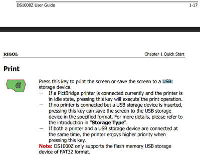

Andrew Neil
Super User
You scope has a USB socket to get screenshots - this will give far clearer results than photographing the screen!

Looking at the waveforms, it's clear data is being sent to the sensor but it's not replying anything. Do you think this is expected behaviour due to an error in the software, or might it be a hardware issue?
I actually looked for a usb drive for this but didn't have one with me at the time of posting so I did my best to take some clear pictures without glare:)
