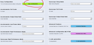

I used Easy Configuration in the Unico GUI.

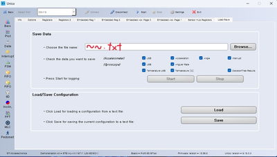

I configurated reg using easy Configuration in the Unico-GUI tool
and I started the IMU sensor and started saving data
then I loaded the data from the Data Patterns of the MLC Part and this result comes out.
Thank you

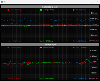

It seems all correct. Can you try, after the easy configuration, to click on START (on the top, near disconnect) and then plot (on the left) ? Are the gyro outputs plotted?
2023-12-03 3:42 PM
Hi Federica Bossi,
The gyroscope works fine.
Still weird when I save and load again
However, if i just turn up the acceleration, angular rate, and temperature, it comes out fine. Why does it work like this?
