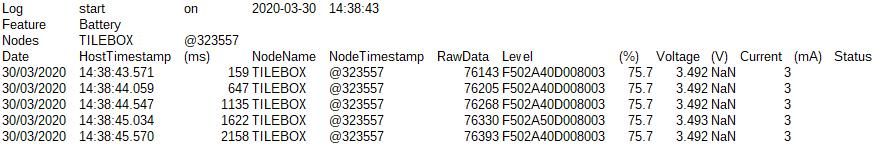

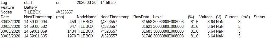

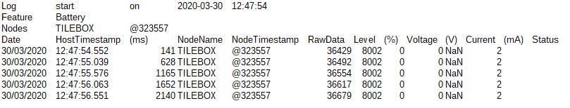

Battery log files as sent via BT and email....

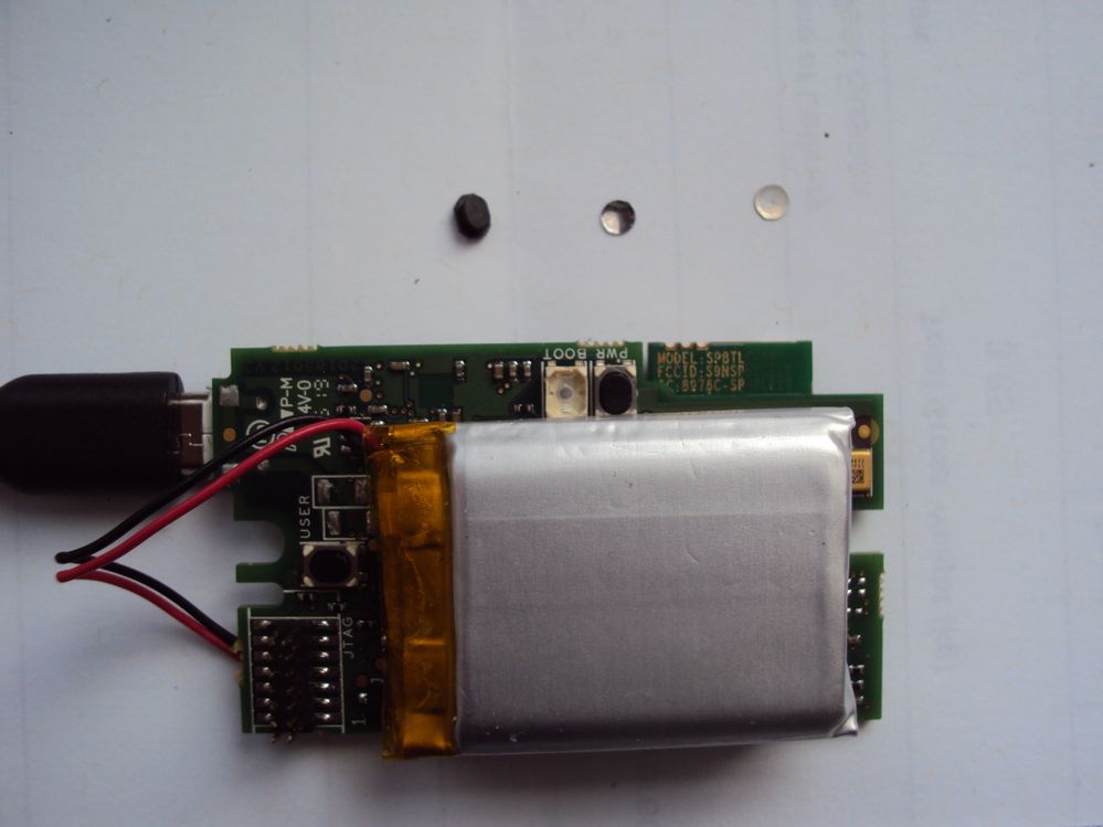

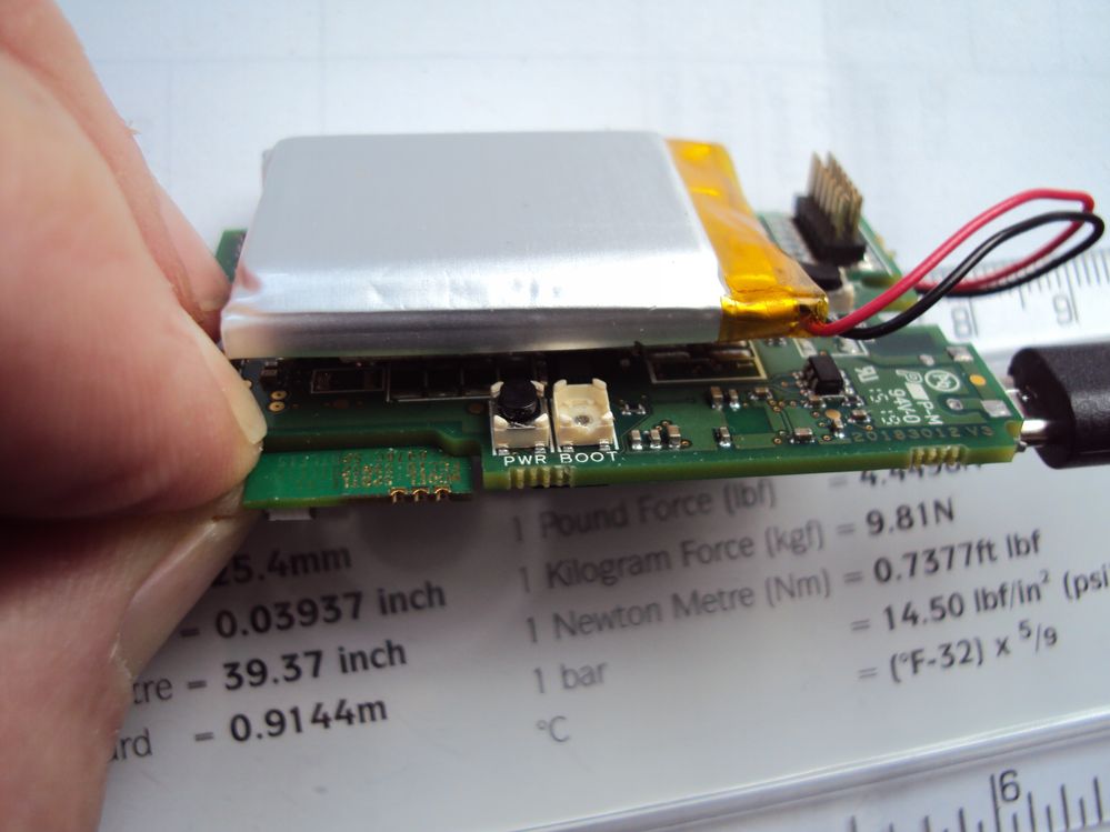

One small problem: the BOOT button has fallen apart and two tiny discs popped out :persevering_face:
However, I managed to temporarily reassemble the BOOT switch and loaded SensorTile.box_BL_334 via USB.

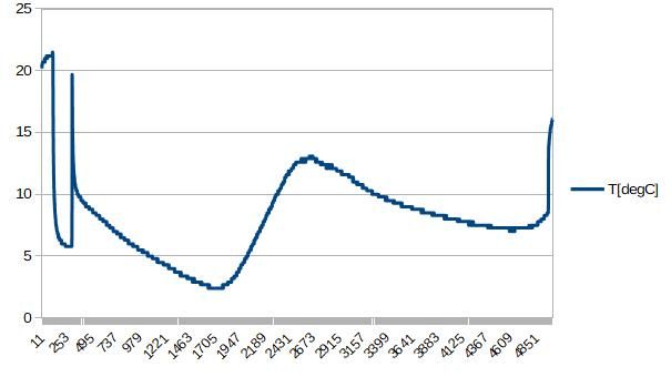

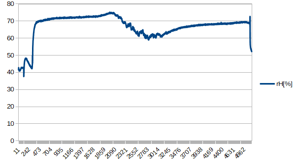

I then set up an App to store time, temp, humidity and pressure every 30 seconds to the SD card.
Excellent! Works perfectly, and it has been in our fridge (at 5C) for an hour then in the loft for 2 days.
Once working, the BT link can be dropped and the SD logging continues.
The battery seems to last forever. 8)
Temperature (above) and rH (below)

Hi Alister, great to hear it! But a question, what do you mean with this sentence? :grinning_face_with_sweat:
Can you please send me a picture of your ST.box (of course when you have finished your tests)
Thanks and regards

Sorry about the delay...my e-mail system would not send photos in 'reply' mode. I must log into the community.st.com site to send photos. I think there is a metal plate missing; if you zoom in enough, you can see a piece of metal which holds the PWR button actuator in. The white plastic housing seems slightly damaged.
2020-04-03 6:50 AM
Thank you Alister, I will immediately share these findings internally. We must improve the reliability of the tool. Regards
