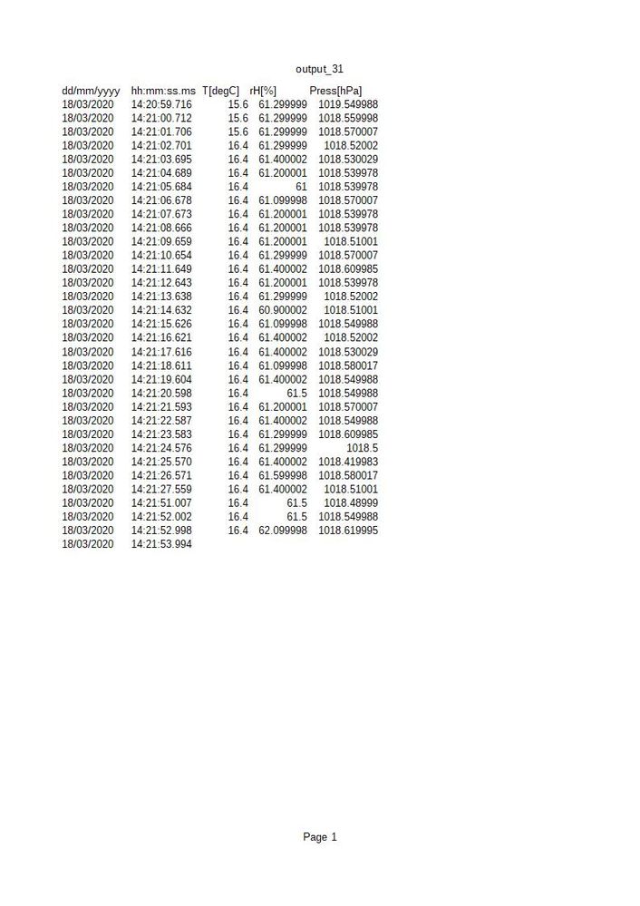

More good news! Sorry about the small print, but I have sensor data (Date/Time/Temp/rH & Pressure) logged to the SD card at a period of 996ms. I don't seem to be able to get any slower (yet) but that's fine for my tests. Expert mode->build new App by taking log SD app and changing parameters then saving as a new app.

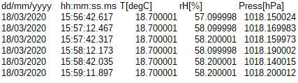

Looking much better. I have set the update to 30 seconds. It is near enough!
Updating the App seems to be more reliable at a distance of 3m. Again, it would be handy to be able to debug the upload failures one day.
Anyway, it downloads a new app most of the time and here are the latest results. 30 sec update log...

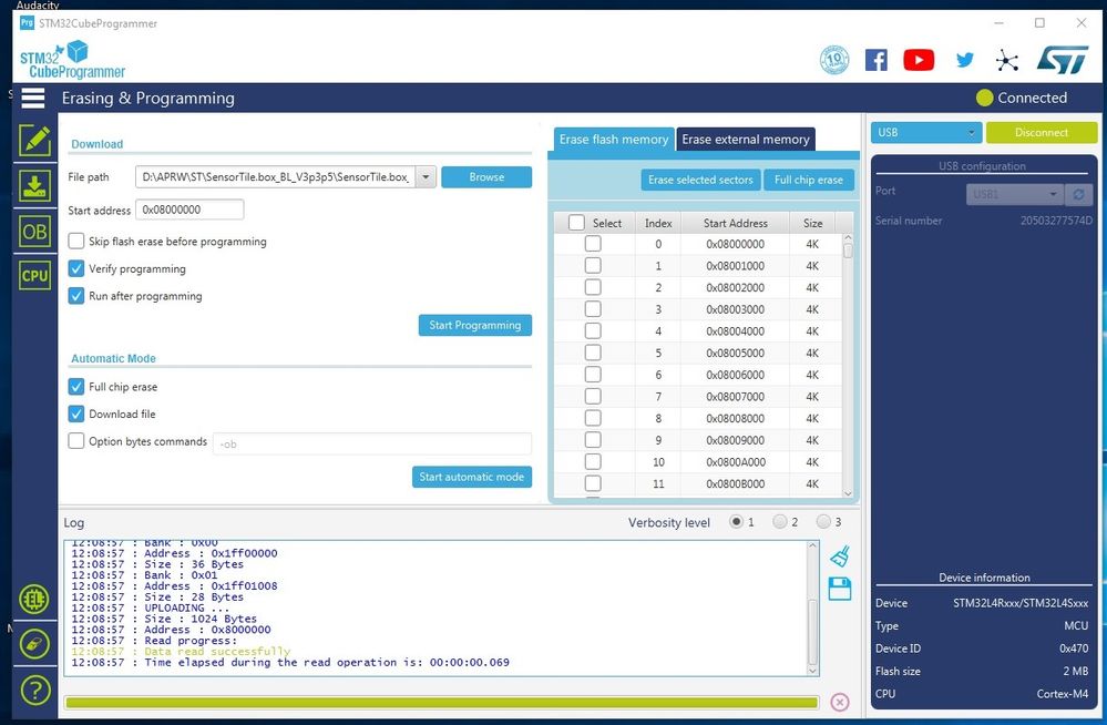

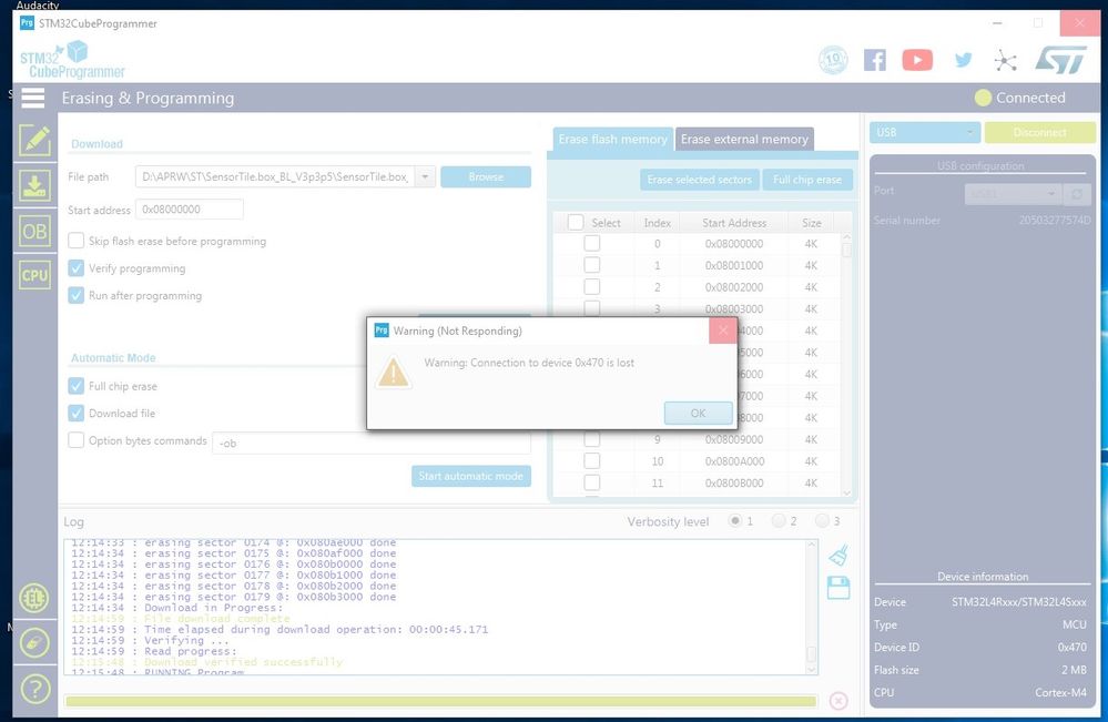

I have tried 3.3.5 but it is still unreliable on the Nexus 4. I cannot download an app in expert mode.
I had to use the USB programmer to get 3.3.5 into the SensorTile because 3.3.4 would not do a software upgrade via BT: it kept failing at random parts of the 700k file,

Hi @AWatt.1 , under which point of view do you think the v334 is more reliable than v335? About the initial firmware upgrade or about the BLE connection / applications working with Nexus 4? I can attach you the SensorTile.box_BL_v334 version here below, but in general I suggest you to upload a new FW with the ST programmer in DFU mode.
>> Can you stream the BT data into an SD file? Plus the reason for failure?
Yes, of course. You can as 1st step use the Datarecorder example. Please note that to see your ST.box as a mass storage device you have to disconnect your app BLE connection.
Regards
