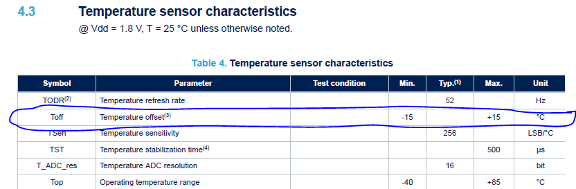

Maybe try to use Vdd=1.8 and see what happens?
if Vdd relation to vout is linear (1,8/3,3)*60=32ºC.... are you at 32ºC right now?
