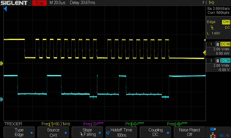

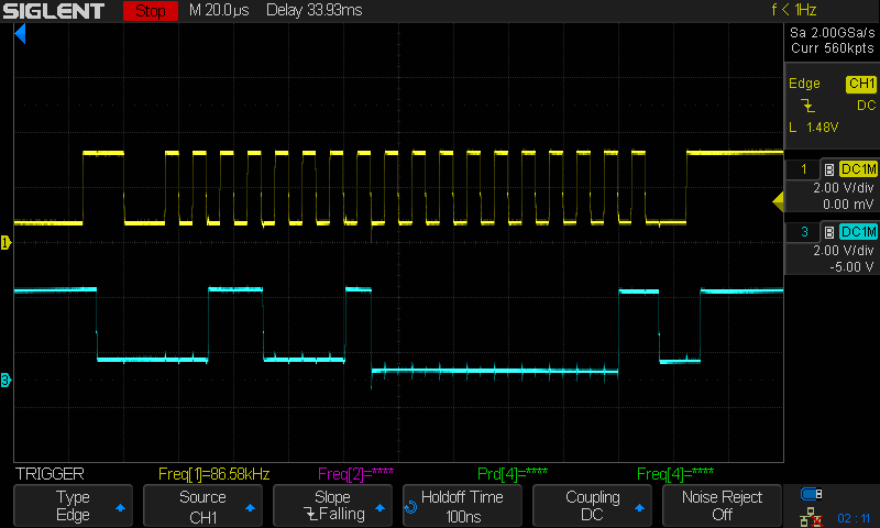

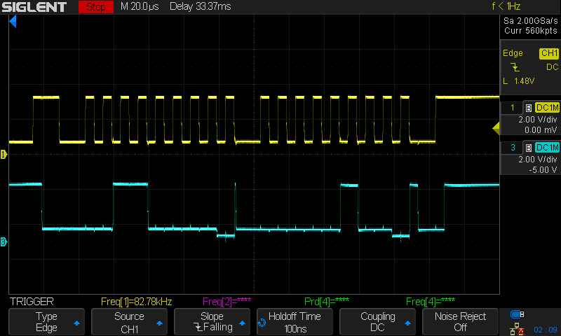

Actually, I found the issue. It turns out that the ST MEMS Zephyr module has a bug, at least for the LIS2DTW12 and the LIS2DW12. The following is from the LIS2DTW12. In the datasheet we see the following I2C sequence for register writes:
However, in the Zephyr module, the sequence is
Notice the repeated START condition. This is verified by examining the code:

}You see that there are two separate transfers. It is finally also verified by scope screens:
