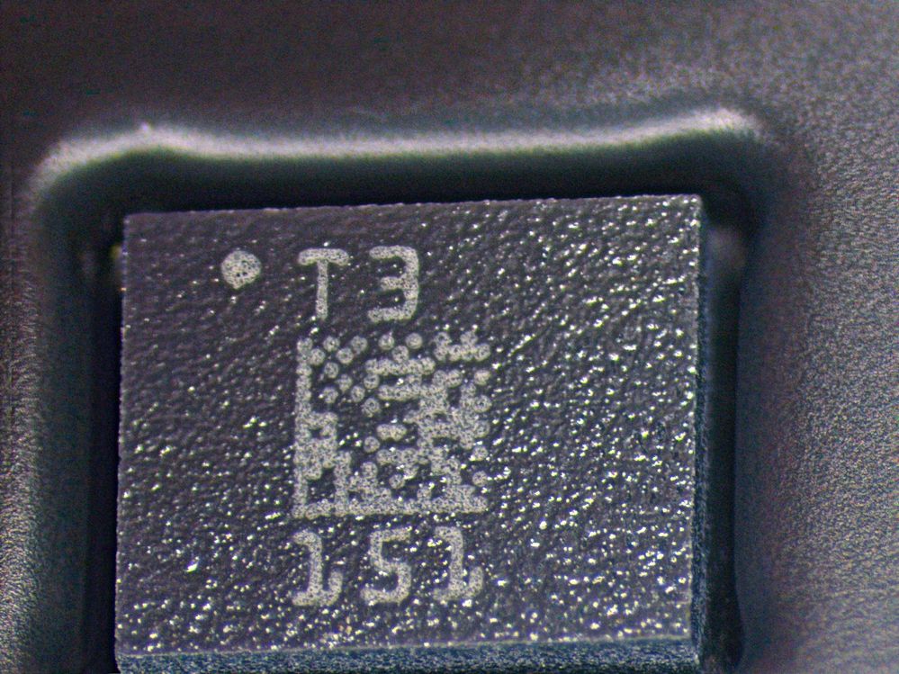

The LSM6DSO32X are marked T3, which can also be found on the packaging bag.
The marking 151 stands for the date of manufacture in the form YWW, in this case 2021, cw 51.

Yes, thank you, that helps alot. :)
