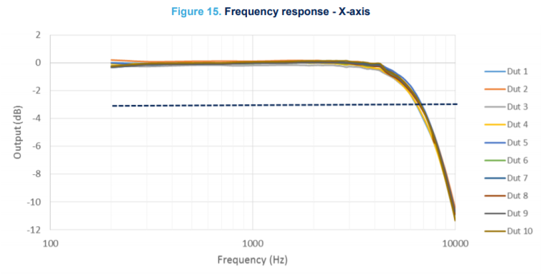

XL_AXIS_SEL[1:0] = xxb (00 = 3 axes; 01 = X-axis; 10 = Y-axis ; 11 = Z-axis)The 6.3kHz bandwidth refers mostly to the frequency response flatness (±3 dB point) of the mechanical element, as you can see from the Figure 15., 16., 17. of the datasheet.
This means that the device can detect a vibration up to 6.3kHz without loss in sensitivity.
