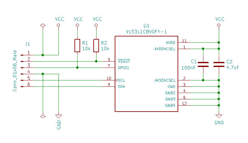

I also made a breakout board for VL53L3CX myself, without TXS0108EPWR for level conversion and it detects just fine every time (check output below).
The schematic for my board is also below.

Note: The chip is VL53L3CX, not VL53L1. Pins are equivalent.
I'm still struggling in terms of software, but at least it is detected correctly.
