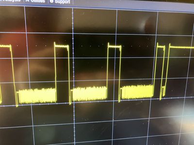

Can you increase the delay between Start and end frame packets.
I want to make sure there's enough time for it to be detected with the STM32N6.
Registers i've tried to use.
* VSYNC_START_DELAY - is for gpio output
* FSYNC_IN_DELAY - not sure what it does
VD56G3 cam End frame packet.

Hello @Brenden_PLUS ,
There is no such register on our sensor to play with the delay between two packets.
Sorry for the inconvenience,
