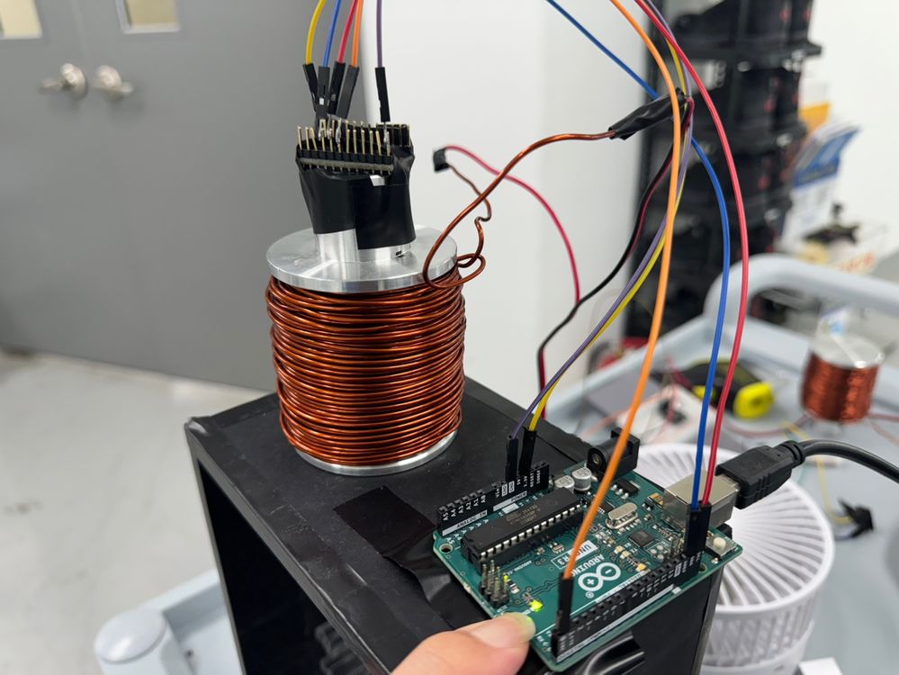

I am currently using IIS2MDC and Arduino Uno to measure the magnetic fields in the form of sine waves generated from the coil.
First of all, the measurement environment is composed as shown in the picture below.

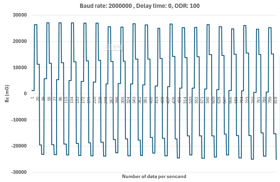

The picture below shows the magnetic field measurements of the coil for AC 20 Hz current at Baud rate (2000000), Delay time(0).

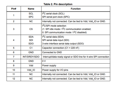

1. I need to connect the cs pin to the Arduino Digital 0 pin for data to come in, what is the meaning of this connection? Also, I'm using the drdy pin without connecting it, and I'm curious about the meaning of these two pins.

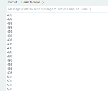

2. When I set the sensor ODR to 100Hz and looked at the magnetic field data value for 1 second for the AC 20Hz current, I could see that 20 cycles were taken. However, there is a phenomenon where several of the same data values are taken. I am curious about the cause and solution to this phenomenon.
(It was improved by reducing the Buad rate, but it didn't go away. It disappeared if I grew a lot of delay, but I don't think it's a good way to reduce the sampling rate.)

To better understand the CS and DRDY pin you can look at the LIS2MDL datasheet:

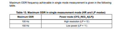

The ODR is not the sampling data rate but it is the output data rate, the rate at which a sensor obtains new samples. To measure AC 100Hz you should set an ODR of at minimum 200Hz but, unfortunately, the maximum LIS2MDL ODR is 150Hz in LP mode in single measurement mode:
