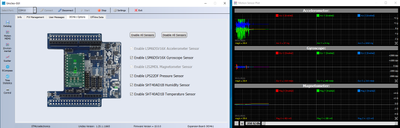

Hi Team,
Any feedback, I try use Unicleo-GUI to observe sensor behavior, it will be more convenient, display as below, looks by default configure as lsm6dsv16x, but my purpose is to use lsm6dso16is to fulfill ecompass feature, how can I change in ECompass.ioc
Thanks a lot!
