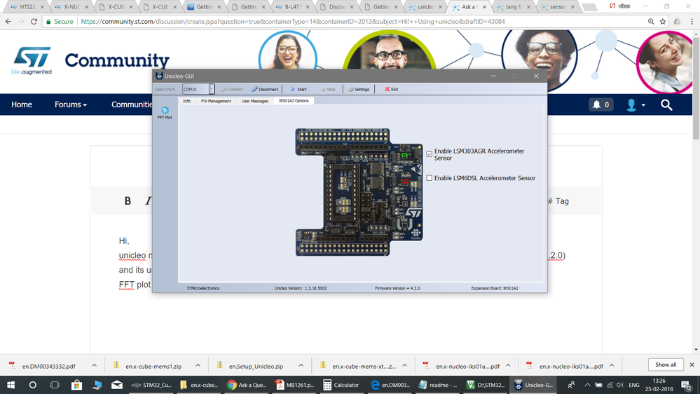

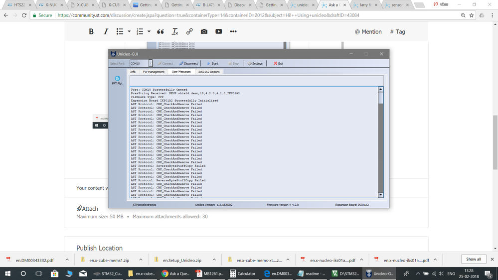

unicleo not working in FFT mode with (&sharpIKS01A2+ NUCLEO-F401RE with STM32CubeExpansion_MEMS-XT1_V4.2.0) and its user message window is showing ''AST Protocol: CHK_CheckAndRemove Failed''.
FFT plot is not showing any graph.

I'm not able to replicate the issue.
I see you have Keil uVision program opened, did you modify the FFT_demo example?
Can you please try to use already compiled binary located in binary directory?

Hi Miroslav,
your timely response helped us a lot !
I must say that you catch the right point and when I programmed it with binary, it worked
But now it is not working with Tera-Terminal software at baud rate 115200 bps; 8 data bits; No parity; 1 stop bit; no hard flow control given in the readme.
I will look into this and update you in the post.

Please try 921600 baud.

Hi Miroslav,
As per suggestion it is working in 921600 baud rate. Then i think it is wrongly mentioned in ReadMe for
115200 bps.

You are right, there is a mistake in the readme.txt file, we will fix it.
