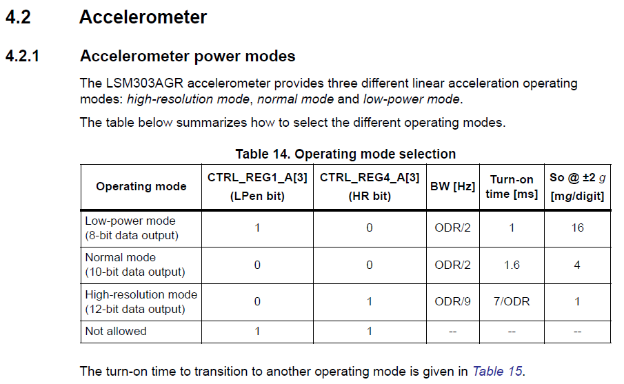

Can anyone explain to me how to calculate the correct acceleration values in mg for various resolutions and scales?
For example, I am currently reading acceleration values with ODR set to 0110, which is HR / Normal / Low-power mode (200 Hz). The Full scale selection is set to +/-2g for this example.
As both the LPen and the HR bit are set to 0, I am in Normal mode with a 10-bit data output. If I shift the values >> 4, I am getting values which seem to be correct. For example 1000 mg (= 1g) on the z-axis, which makes sense I guess, as it is 1*gravitational acceleration.
On the right of the table above is written: +/- 2 g [mg/digit]. What does that mean? How am I able to convert the values I read into mg? Not only for +/- 2g, but for a fullscale of +/-4g or +/-8g or +/-16g too?

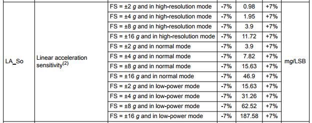

The value which describes relation between raw data and acceleration in g is sensitivity. You can find the values in Table 3 if datasheet for all full scales and modes.
The output value is left justified in the output 16 bit register, so you have to first shift the value right according to selected mode (8, 10, 12 bit).

result_mg = result_lsb * sensitivity; // LSB to mg, see sensitivity in datasheet

: Hey Miroslav. Do I have to shift result_lsb >> 8 if the resolution mode = 8bit output (low-power mode)?And is result_mg = result_lsb * 7.82 if I assume that wie have FS = +/-4g in normal mode? Thanks for your help!
2018-03-06 1:10 AM
Yes, you are correct.
low-power mode ... >> 8 bits shift
normal mode ... >> 6 bits shift
high-resolution ... >> 4 bits shift
