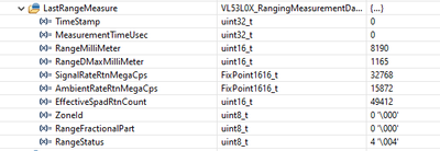

2023-11-20 12:26 AM
Hi Seb,
An update, my problems where related to hardware and noise while calibrating. after making some changes to the calibration sequence and room variables (block out external light etc.) the sensor is now measuring beyond the 1,2m and shows accurate data.
I am currently polling for data ready so i don't use the interrupt status value.

After throwing away the RangeDMaxMillimeter variable problem i am now left with the reason why my sensor does not measure beyond 1,2m. as soon as the measurement goes beyond 1,2m i get the following resulting measurement data:
Can anybody help me make sens of the values to check where the problem is (in software or surrounding noise etc).
The RangeMillimeter variable holds a value 8190 if i go beyond 1,2m from the sensor, before the 1,2m it holds an accurate value.

2023-11-18 1:17 AM
hi, did you triy to read the register 0x14 who is Result interrupt status and decode it ?

DMAX is a very mis-understood number.
It's a function of ambient light. It says, "Given the amount of ambient light seen, a target can only be detected up to this distance." Said another way, "I cannot see beyond DMAX due to conditions".
The sensor can 'see' to 2M in ideal conditions. Near a window, there could be enough sunlight to reduce that max distance to that Dmax range.
Cellphone companies wanted that number to start an autofocus search at DMAX. So even if the sensor saw no target, they could save a lot of time, not needing to autofocus at the short distances.
As to your startup, I would always toggle the Xshut down line at the start.
