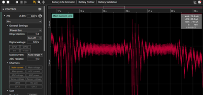

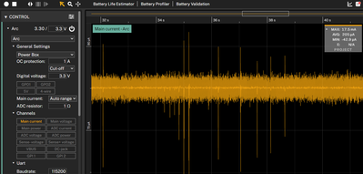

But in this mode it still reacts and consumes power when there are activity like several shocks next to the module (see power-down_behavior.png).
As we can see on the screenshot, I can get correct value (around 2-3uA) but only during a short period after a shock (272ms on the example).
Then after this delay, the module consumes energy and reaches an average of 100uA.
After that even when I setup the Low-Power mode 8bit with ODR 10Hz with full scale selection to 2g .
I get the same wrong behavior with a good consumption just after a shock and bad consumtion after a certain delay (see low-power_behavior.png in attached files).

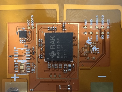

For current measurement I use the Otii Arc Pro by Qoitech and use it has Battery thru J1 connector (BAT+/BAT-). On this board there is only the LIS3DH and the MCU RAK3172 SIP module. Other modules like ECC, EEPROM,Temperature Sensor or BMX160 are not connected as you can see below :

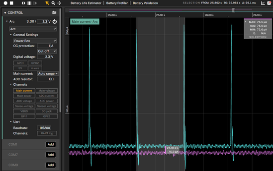

The behavior is much better but when I setup the power-down mode, the consumption profile still has some very small reactions to shocks as you can below, nothing compared to the other board by the way.
Also I've taken another RAK2270 board in order to compare. It also reacts, more than on the Adafruit but less than the first board.
On the screenshot below we can see in pink the consumption in power-down with a ground consumption of around 75uA (3v3 regulator, ...).
In blue, the LP_Mode with ODR set at 10Hz. As expected this mode adds around 5uA and the acquisition period is 100ms.
On RAK2270 boards I use the same commands as on the Adafruit, and as I said previously, there are only two elements, the MCU and the LIS3DH module.
Based on your experience, what can make the module reacting to shocks even when I send the power-down command ?
