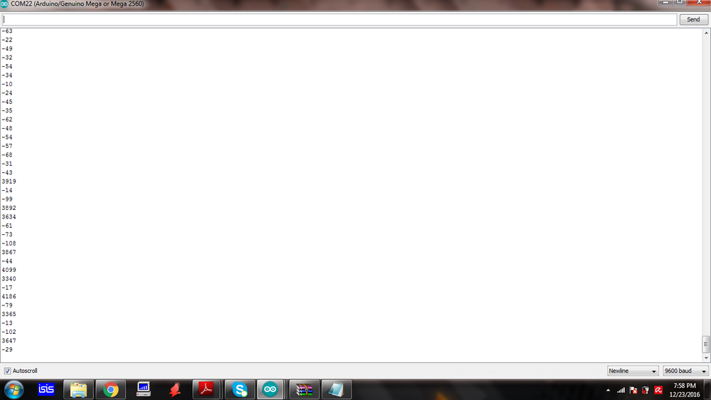

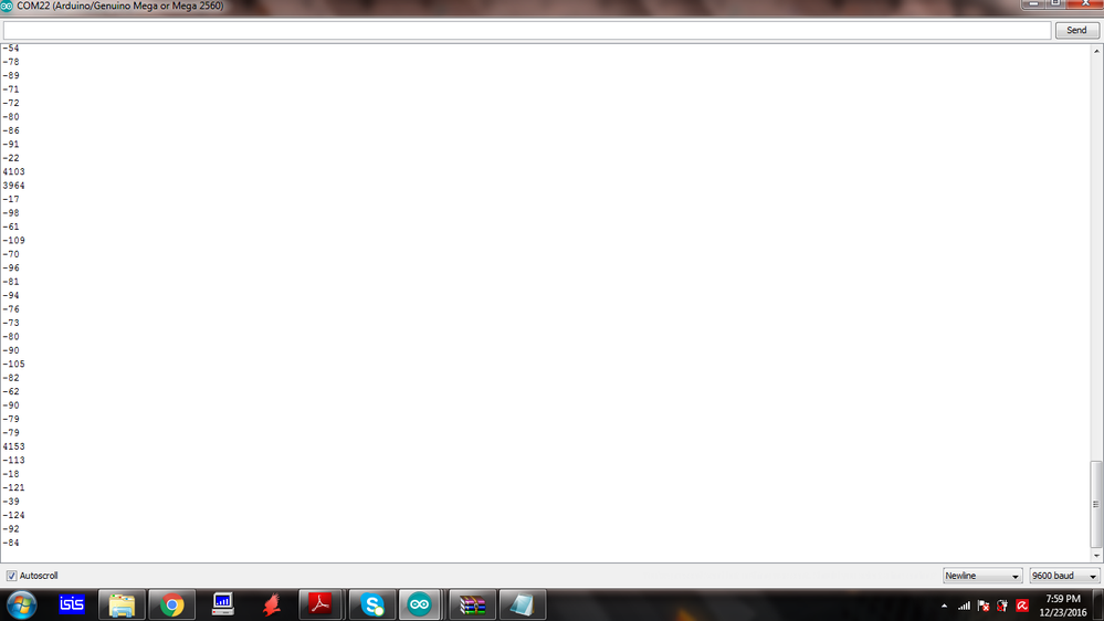

2016-12-23 7:43 AM
Changed the value in CTRL3_C to 0x41 , attaching the images of output values of x,y,z of accelero , all axis are tested with +1g, x gives perfect output, z and y gives some valid output when i give some knock on the table where sensor board is placed.
