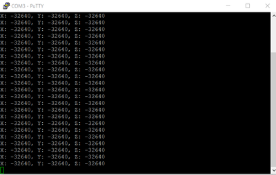

However, after writing my program, I realised that the program only outputs a constant reading of -32640 for all axes as shown below even when I move the accelerometer.

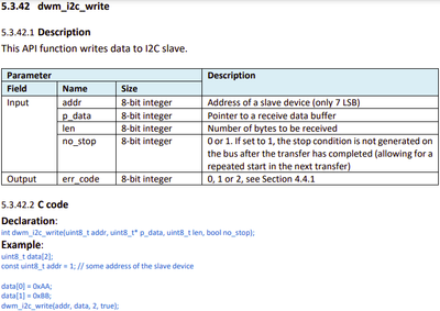

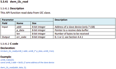

My code mainly uses the dwm_i2c_write() and dwm_i2c_read() functions from the dwm.h library with the descriptions of the functions as shown:
