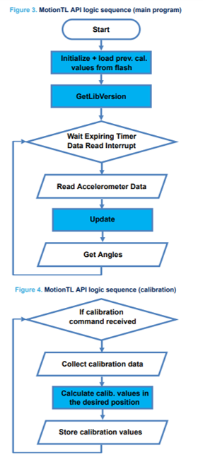

Hi @KRam , taking the tilt angle measurement application (but the same for the heading angle), it is not strictly necessary to perform a preliminary compensation (AN4509). However, it is warmly suggested to follow a calibration procedure at the beginning: to increase the accuracy of the measurement it's better to know the initial position in all the application that need an integration of the sensor output data (so neglecting all the accumulated offsets), such as the acceleration or the angular rotation when used to get the relative position, especially in a static or quasi-static case.
You can refer to follow the MotionTL library suggestions, based on the accelerometer only. The application flowchart is the following one:
Btw, please consider that there are devices properly designed for tilt measure, such as ST precision inclinometer IIS3DHHC.
